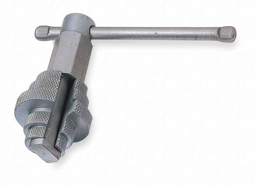

Postby thecleveman » Sat Apr 21, 2012 18:41 18
I use the bales adaptor. It was a bear to get the old one out (use a pipe wrench, as instructed), but now it works great, and I use much more highly rated filter, high end purolator. They had never made one for the burgman (650) before, but now they have. Excellent to deal with.

Postby Corvetteowner » Sat Apr 21, 2012 20:15 20
thecleveman wrote:I use the bales adaptor. It was a bear to get the old one out (use a pipe wrench, as instructed), but now it works great, and I use much more highly rated filter, high end purolator. They had never made one for the burgman (650) before, but now they have. Excellent to deal with.
Thats why I'd like to install the adapter... You can use a MUCH higher quality filter.... I'm very afraid that I could strip the receiver part that holds the other end inside the engine block... I would probably buy the reverse threaded locking removal tool because I'm such a chicken... :lol:

Postby thecleveman » Mon Apr 23, 2012 21:19 21
All I can say is, "Go for it..."
The extractor was not available when I put my new adaptor on, it looks like a really neat method.

Upon looking at the oil filter adaptor extractor from the Bales Tech website. It looks like a standard broken bolt extractor. Or possibly a standard broken bolt extractor with it's end cut off so it will fit in the shallow recess of the oil filter adaptor.
It would be a good item to purchase if you don't already have a broken bolt extractor.

Since the Suzuki part being removed is reverse threaded, I suspect the removal tool is also... So a standard broken bolt removal tool will not be machined in the correct direction to facilitate oil core removal.... So the one you have in your toolbox will not work for this particular job!!!

rtAnimal wrote:Upon looking at the oil filter adaptor extractor from the Bales Tech website. It looks like a standard broken bolt extractor. Or possibly a standard broken bolt extractor with it's end cut off so it will fit in the shallow recess of the oil filter adaptor.
Corvetteowner wrote:Since the Suzuki part being removed is reverse threaded, I suspect the removal tool is also... So a standard broken bolt removal tool will not be machined in the correct direction to facilitate oil core removal.... So the one you have in your toolbox will not work for this particular job!!!
"You can purchase them at Mcmaster-Carr (item #57195A523)" http://www.mcmaster.com/#catalog/118/2851/=h8vq5o but it says they are for right handed threads.

If it's a reverse thread on the oil filter adapter. I also have some of the hammer in 4 sided broken bolt extractors. I normally use them as they seem to grip better. I guess that would be the only option considering that company doesn't make the extractor for the Burgman 650. I wouldn't want to use a pipe wrench nor vice grips. As both of those would damage the threads on the OEM adapter.

Maybe something like these?
